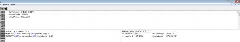

You can use this function to convert a DWORD into 2 WORDS.
For this function to work 'Util' library should be added to library manager.
Note: Works for only positive values
FUNCTION DW_TO_2W : ARRAY [0..1] OF WORD
