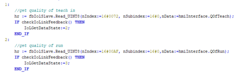

habe mir aktuell einen Baustein um den FB_IOLRead gebaut um diesen einfacher verwenden zu können. Das Selbe habe ich bereits für den FB_IOLWrite gemacht, da klappt soweit alles. Leider funktioniert es mit dem Read gar nicht. Egal was ich mache, es kommt immer "ADSERR_DEVICE_INVALIDPARM" als Fehler. Die Parameter sind dabei fast 100% identisch zum schreiben. Ich will zum testen erstmal nur lesen, was ich gerade geschrieben habe. Hat jemand ne idee was ich falsch mache?

FUNCTION_BLOCK ABSTRACT FB_IOLink_Base
VAR
    // IO-Link Terminal specific values
    amsnetid_EL6224 : I_AMSNETID_Input;
    connected_IOLink_port : E_IOLPort;
    // Reading
    IOLink_read : FB_IOLRead;
    eading_state : (IDLE, READ, WAIT_FOR_SUCCESSFUL_READ);
    execute_read : R_TRIG;
END_VAR
METHOD Read_IOLink_BYTE_Parameters : BYTE
VAR_INPUT
    execute : BOOL := FALSE; // Must be set TRUE to write parameters
    IOLink_index : WORD; // Provide the processed data as dec
    IOLink_subindex : BYTE; // Provide subindex fitting to index
END_VAR
VAR
    IOLink_value : BYTE; // Provide the actual value that should be written
END_VAR
Read_IOLink_BYTE_Parameters := 0;
execute_read(CLK:=execute);
IF execute_read.Q THEN
    reading_state := READ;
END_IF
CASE reading_state OF
    IDLE:
        // Do nothing as long there is no edge on execute
    READ:
        // Do the actual reading with the provided input parameters
        //IOLink_read(bExecute:=FALSE);
        IOLink_read.bExecute:=FALSE;
        IOLink_read.sNetId := F_CreateAmsNetId(amsnetid_EL6224.State);
        IOLink_read.nIolPort := connected_IOLink_port;
        IOLink_read.pDSTBuf := ADR(IOLink_value);
        IOLink_read.cbBufLen := SIZEOF(IOLink_value);
        IOLink_read.nIndex := 16#128;
        //IOLink_read.nIndex := IOLink_index;
        IOLink_read.nSubindex := 0;
        //IOLink_read.nSubindex := IOLink_subindex;
        IOLink_read.bExecute := TRUE;
        reading_state := WAIT_FOR_SUCCESSFUL_READ;
    WAIT_FOR_SUCCESSFUL_READ:
        IF IOLink_read.bDone THEN
            IOLink_read.bExecute := FALSE;
            reading_state := IDLE;
            Read_IOLink_BYTE_Parameters := IOLink_value;// Signal success by returning TRUE
        END_IF
END_CASE
IOLink_read();
