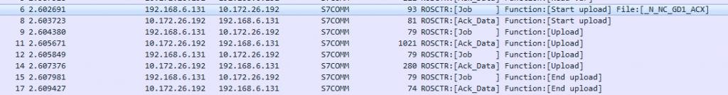

PLCConnection _myConn = new PLCConnection("ReadFromNck");
_myConn.Configuration.CpuIP = "192.168.214.1";
_myConn.Configuration.CpuSlot = 4;
_myConn.Connect();
var tag = new NC_Var(0x82, 0x41, 0x21, 0x1, 0x7F, 0x1, 0x13, 0x20).GetNckTag();
//var tag = new NC_Var(0x82, [FONT=arial black]0x40[/FONT], 0x21, 0x1, 0x7F, 0x1, 0x13, 0x20).GetNckTag([FONT=arial black]1[/FONT]); //Kanal
_myConn.ReadValue(tag);

#region ACX File laden
byte[] bAr = _myConn.BinaryUploadFromNC("_N_NC_GD2_ACX");
byte[] GudFile = new byte[bAr.Length - 24];
Array.Copy(bAr, 24, GudFile, 0, GudFile.Length);
#endregion
