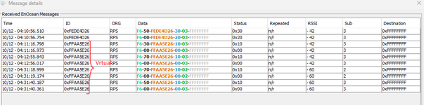

I can receive telegrams from the EnOcean button via “antenna KL6583”+ KL658+PLC.
I can send telegrams with help of FB_Send_RPS_SwitchAuto (virtual EnOCean button).
But the data inside messgae is different from what I have when EnOcean rocker switch (button) sends.
I scan EnOcean telegrams (mesages) by Thermokon Air Scan.
EEP (EnOcean Equipment Profile) in both cases is the same = F06-02-01 (Light and Blind Control - Application Style 1)
Currently, I don't know what should be equal in the commands of the virtual button with the real EnOcean button for the EnOcean activator to work with the virtual one.
Beckhoff transmitter (antenna) EnOcean ID is different from EnOcean button - it is Ok.

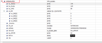

What should be in the structure VARstKL6581 to control Actuator (ON/OFF/DIMM) ?

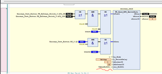

Currently I deal with Beckhoff TwinCAT functional blocks for EnOcean: FB_Send_Generic and FB_Rec_Generic.
I can send commands ON/OFF/DIM and control from "virtual button" to the EnOcean lamp Actuator.
To pair "virtual" button and Actuator the "teach" process was made (with help of service button inside Actuator).
I didn't find the possibility of direct control the Actuator by its ID without "teaching" process. This is probably a "safety" standard.
I didn't find the TwinCAT instruments to make a full immitation of physical EnOcean button (in other words with fake ID). Again it is probably a "safety" that comes from original EnOcean tranciewer that is used in Beckhoff antenna.
Actually, I wasn't looking for a way to hack EnOcean. I needed to solve a utilitarian problem using the most standard methods and means.
Maybe it will help somebody.
In terms of Beckhoff for FB_Send_Generic and other EnOcean FB:
input "nEnOceanID": Virtual EnOcean ID; a value of 0 to 127 is added to the real EnOcean ID (valid values: 0 to 127).
With this number you can create 127 devices with other identical parameters on one node (EnOcean antenna).
In my example it is different "virtual" buttons (different from the perspective of a EnOcean third-party physical device) that send telegramms via common EnOcean antenna.
This example of Actuator control from virtual buttons "bSwitch1" and "bSwitch2" simultaneously with real EnOcean buttons "FB_EnOcean_Switch_0.bT2_ON" and "FB_EnOcean_Switch_0.bT2_OFF".
Example shows only "Send" part of the algorithm.
