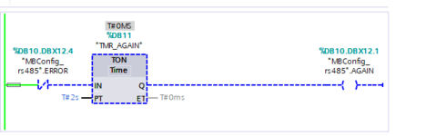

rs485 problem:
my blocks for rs485 looks like this:
I am getting status 7001 and errors 8188 8281. Again help would be really appreciated. In tia portal they say it is about the port mostly. but the port I use looks like it functions. Couldnt find out what the problem is with it. I don"t see lights on it but many people said it is normal in TIA.

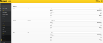

also here is the modbus rtu settings in bender device: 1721218410372.png

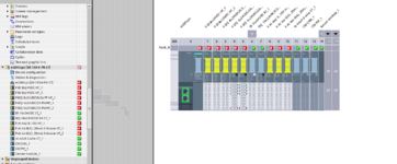

the last problem: the Profisafe problem
my problem with the Safety programming, is that I am getting errors on my F-IO`s and becouse of this I cannot get the cpu to run.
It might be becouse I havent connected anything to the F-IO`s, but I really don`t know. the TIA forum had many many different answers, and I am trying most of them, some of them are not even doable for me. I have de-activated the F-cpu in the S7 1500, to be able to try out other programs.
when I activate F-capabilities of the cpu; and download the program to it, it doesn`t go in run mode anymore. there are lots of errors that it gives, I am out of pictures to post here, but I will eventually give more data about this issue.
Thank you for being here and reading my post, I would really appreciate any help and will be as fast as I can to reply and try out solutions in order to finish my projects technical initialization part.

have you assigned the Profisafe address to the cards? Right mouse button
Do the online and offline cards match? Are they the same article numbers and versions?

I tried, it says online and offline are not the same versions. I will check again tomorrow, and also add a screenshot.
they are matching, only the firware are a bit different, but its the only version on my tia, for example it is v2.0.2 for some modules, but tia only has v2.0, still cant do it.
my modules and versıons are correct ı guess.
it says the f-parameters are different, and slot locations are different for each module.
Have those modules been used in another project before? Does the led flashing match the slots of the devices?

They have been used in another project before.
I am re-using them, I just read somethings about re-using just now, is there a way to use them now? I am kind of lost in lots of errors...
When you say reusing ... do you use the same Baseunits?
Main Reason for my question is, if you have the white memory plugs from the F-Cards, that usually remain in the Baseunit ...
Just to get a picture:
In most cases when the assigning of F-Adresses fails there are 2 main reasons:
1. No Voltage Supply of the cards
2. Problem with the memory plug
When you right-click on the card, then you should also get an more detailed diag of the specific safety-card.

about the modbus tcp, I
the device I am using has this modbus settings: https://www.benderinc.com/fileadmin/content/Products/m/e/iso685_D00022_A_XXEN.pdf
and I was able to read them using modbus poll, have tried 40001 42000 and some randoms also, still no chance :(
To have the equal of modbus poll you have to use 8192, no 4 in the beginning.
Biggest MB-Register according to your manual is 29699, but you are reading register 40001 ...

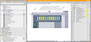

Hello again, so this is the situation now... I don`t know why, but I cannot take data from modules...
says this for each module, any suggestions? I looked and the firmware versions are the same, tried removing and re-inserting, still doesn`t function.
I will try to reupload the firmware versions.
reuploaded the firmware version of et200sp, still no luck
