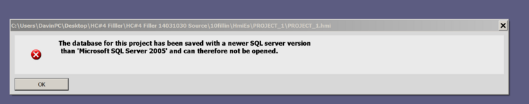

hi everyone
I am encountering this error when opening a project created with WinCC flexible
he database for this project has been saved with a newer SQL server version , then Microsofe sql server 2005 and can therefore not be opened
The WinCC Flexible installation CD includes a specific SQL Server version.
The SQL Server version included with WinCC Flexible is optimized for use with WinCC Flexible.
If a different SQL Server version is manually installed or upgraded, projects may no longer be open due to software is incompatibel.
You must install the SQL Server version included on the WinCC Flexible CD
