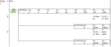

I have made a FB, for Scale_Real, And Scale_Word and Scale_DWord. It will be nice to have a Scale_Any in the firmware. But as i can undestand it's not posible to get.
X-Y Conversion (Can alsow be used for scaleing)
See:
And in Simulation:

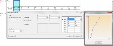

Hi again.
It works a little like the scale function.
Here is a little from the Help File:
You made a Curve, in this case 3 Points.
1: X0 Y100
2: X100 Y0
3: X300 Y100
Example: Y to X
"40" (Register D95) on the Y axis, it's read out on the X axis to "60" (Register D30)
The other example;
"250" (from Counter C30) on the X axis, it's read out on the Y axis to "75" (Register D90)
