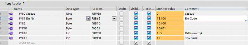

I want to trasfer it over Profinet IO (ILC131) to a Siemens Master.

Hello
It works like i want it to... if i just skip the first 8 bytes... ;)
The biggest problem is that the function has a R_Trig input, but if i use a clock pulse on it, i think it can work as it should anyway.
On my Siemens S7-1200 (Master), i connect to the Phoenix ILC131 (Device) over Profinet.
Then i just read the bytes in the Siemens Controller.
In this Example from the Siemens, it's not the Teststruct i'm reading out.
I know i can use special Siemens ISO communication library, but i want it to be directly on profinet, so it's easy to use on other vendor PLC's alsow.

Hey Mark
Buf_To_Byte worked better. (Without checksum)
But i dont see any change in the byte order if i True Buf_format?
See my test here:
I use a ILC191ME/AN
