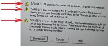

The message appears during the program download
Davin
25
Hello everyone, when downloading the program in RSLogix I encountered this message. Will there be any problem if I proceed with the download?
The solution is making sure that there are no active servo axis at the time of download.
I don't know anything about the memory behaviour in your PLC, so I won't comment on the last point.
