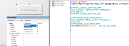

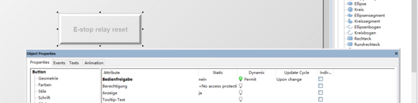

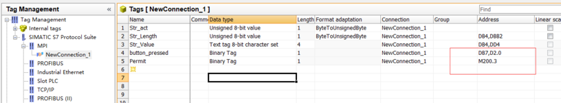

According to these, I tried to remove the M200.1 variable from the AND operation in network1. Delete or not delete this variable, the function is the same. The variable M200.0 "emergency stop relay reset" results are all 1 , What is the meaning of the author writing about this variable ? I use s7 400 and wincc 7.5

1: There is some "E-Stop reset" button with a dynamic condition to permit or deny that this button gets pressed.
2: The button has a click event with script which contains a tag which gets set but not resetted by the script.
3: The "button_pressed" tag from (2) and the permission bit is declared in the HMI connection.

I am guessing M200.1 is some logic to control that M200.3 "WinCC_allowed_to_press" is set, and that triggers the display of the reset button in the HMI. If you find where M200.1 is set via the cross reference, then it will probably be clear.
