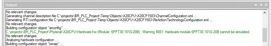

I am working with the B&R PLC CP 1583. I am trying to program the HMI panel. When I try to simulate in BR automation studio its saying( Hardware module 6PPT30.101G-20B cannot be simulated).

It is only possible to simulate new Hardware. For older Hardware it is necesary to build a duplicate configuration only for simulation, but this is not a simple task. Please contact the B&R Helpline for help.

I have red somewhere the simulation error is for the hardware buttons i used in hmi.
I cleared that error and Now I cannot able to transfer my hmi pages to the HMI target display. The automation studio is saying its transferred the hmi pages to the target. but i can see no changes in hmi display.
please write me if you have any idea about it.
Restart the HMI, restart the PLC.
I thought, the HMI is calculated on the PLC not on the HMI-device. You have to update both devices.
But maybe I'm wrong.
