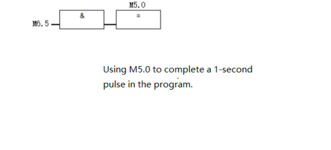

What's the best way to generate a 1s pulse in a PLC program? The first way is to use a clock memory with rising edge instructions, and the second way involves using logic instructions like AND, OR, and NOT to handle the clock memory. I'm using STEP7.

In the PLC program, we often use the method from 1.png to generate 1-second pulses, while the method in 2.png is only used in OB35.
What are the advantages of using the method in 1.png?

2.png is incorrect, new_2.png is correct.

You didn't answer my question. What do you need the pulse for? Or a cyclical clock?
The clock bits of the CPU clock memory byte are asynchronous to events from the process and asynchronous to OB1.
The clock bits can simply be used as a flashing clock for lamps or to count seconds, but not for a pulse that must start when an event occurs.
Example:
                 +---+     #out
"clockbit_1Hz" --| & |     +---+
    "condition"--|   |-----| = |
If the condition becomes true then #out will be
- either true immediately, but for less than 0.5s
- or true up to 0.5s later, but then for exactly 0.5s
---> #out is not synchronous with the condition

Generate a continuous 1-second pulse without interruption. For example, when the fault wait time for the valve adds up to 3 seconds, a failure alarm is triggered.
However, in the PLC project, the clock memory byte is completed with logical instructions (e.g., XOR and AND) to generate a 1s pulse.
