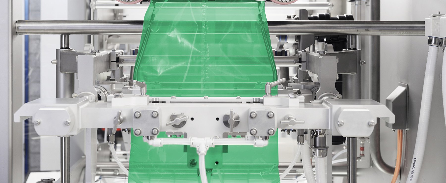

Hi all engineers
I have one machine from Bosch Packaging Line Technology, made in 2007
The exact model of the device : Bosch SEV 2510
Bosch CPU is used in this device, and it is connected with a computer with Windows CE operating system.
Unfortunately, the CPU battery was empty and the set parameters were lost. Now the technician's password to set the parameters is lost.
Does anyone know a way to create or find the password for this device

The type is probably not
Bosch SEV 2510
but SVE 2510.
Bosch packaging was sold from Robert Bosch to an investor, have a look here:
SVE is written on the catalog with the device and the name of the device plate is SVE.
Unfortunately, there is no explanation in the guide for when the device password is lost
