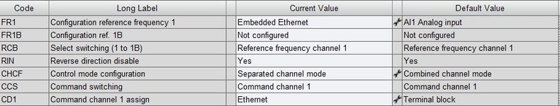

For the VFD parametrization, I have configured it using the SoMove software (a GUI for the VFD configuration from Schneider Electric), aside than the intrinsic IP assignment, as follows:
Configuration reference frequency : Embedded Ethernet (the default value is AI1 Analog input)
Control mode configuration : I/O mode (the default value is Combined channel mode)
Command channel 1 assign : Ethernet (the default value is Terminal block)
According to what have been precedent, the VFD is set to receive the reference frequency via Modbus TCP, where the value for the latent is to be sent (written) from the PLC.

This is how I communicate with 3xx, 6xx and 9xx, examples written out of my 6xx ATV-FB (can't give the whole thing out, sorry)
My ATV6xx-FB requires this to be set to "Separated channel mode"
In Parameters List->Fieldbus
->Generic Setings set "Swap Word order" to "ModBux Word Order OFF"
-> Protocol & Drive Profiles must be set correct. Iam telling the VFD here what I want to communicate:

Hi Harold, and thanks again.
As for the data type of: "Modbus_Master_Write_DB"."Frequency Write" it is of USint and its value is "50" (ie, I want the reference frequency to be of 50Hz).
The VFD is communicated through via Modbus TCP. I can test/debug it using its "Test Client App" which is SoMove. I can set the desired reference frequency using that App and see its reflection on the VFD's embedded LCD without any problem.

I now have the 1515-2PN loaded with the MB_Client FB (the connection criteria between the PLC and the VFD is well established). Concerning SoMove configurations, attached it is what have been changed.
The purpose is to only send the LFR (logical address = 8502) value from the MB_Client in the PLC. Unfortunately, I keep receiving the same output as initially!
