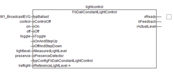

Hello,
I currently working on a automated lightning system but I've got a problem with the function block : "FbDaliConstantLightControl" of the building automation library from Wago. After few tries, I still don't understand how works this block, and the VAR_IN_OUT : "rReferenceLightLevel" but after some tests, I still got errors at this subjects. Firstly I execute the block with a classic IN_OUT variable but it send me the error 4061 "must be used" then I define an initial value but I guess that it can't. So I'm currently totally lost, I'll be glad if someone can help me or gave me an example of an VAR_IN_OUT.
edit : Sorry I'm pretty sure i wrote this topic in english but i guess my translator automically translate it.
