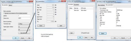

1. What Tools do you use for driver configuration (what is the driver type)? Is the driver reachable through these tools?
2. more bold doesn't help here
Through MCT10 tool the driver is reachable and I could access it using some mft PRofibus adapter.. I use MCT10 to configure the driver..
I couldnt access the driver using ACCON-NetLink-USB Compact (which is also a Profibus adapter)..
I don't know MCT10 - is the driver a siemens kompatible SINAMICS or Micromaster?
i think that are the ones AGLink supports - what make you think AGLink can work with your driver - is there a compatiblity list or something?

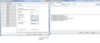

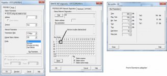

Yes the driver is SIEMENS compatible .. Bit more, The driver can be accessed using Siemens CP5711, 5611, 5613 profibus adapters..
I am trying to access the same driver using Accon Netlink USB compact adapter , it is not working this is my problem precisely.
nice unreadable micro screenshots :)
and can you connect to the driver with your MTC10 program when using USB Compact? (i think you need to switch something in the Siemens CP config)
No I cannot connect it through MCT10 also with USB compact .. everything is fine with Cp configuration..

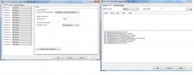

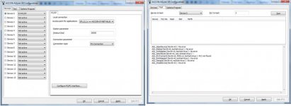

But you should see your drive and the other devices in the lifelist. Use your Siemens CP in auto mode, go to diagnosis andcheck your busparameters and the lifelist. Post the screenshots. Post the screenshot of you ACCON-NetLink USB compact configuration.
Change the HSA from 15 to 126. What do you get now? First of all, we need the device in the lifelist.
Btw: you can't connect the MCT10 with ACCON-AGLink, neither with CP5711 nor ACCON-NetLink-USB compact, but the MCT10-Software should run with ACCON-NetLink-USB compact.
How do you switch from Siemens-CP to ACCON-NetLink-USB compact? Do you have both connected to the bus at the same time? Or do you unplug one and connect the other?
