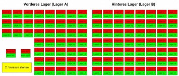

Hello forum,
For my project I am working on a TIA portal for programming an automatic storage and retrieval system, where there are two places: 1. for the storage of incoming products and 2. for the retrieval of stored products and also two shelves A and B are available, as indicated in the picture. I also need to control three servo motors to access the location.

Hello winnman,
So my question is how to program this system means how to build algorithm for his system in SCL language? I want to know general logic for this...
